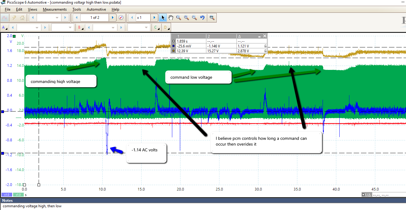

2008 Ford Taurus SEL, BATT/Charging/Starting Waveform
Posted to the Waveform Library on 7/15/2017
commanding via scanner high and low charging requests
