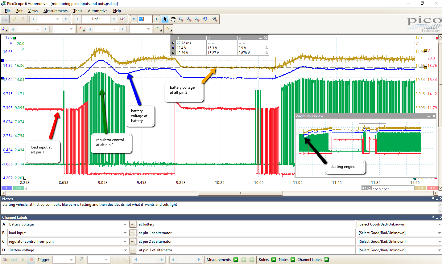

2008 Ford Taurus Limited, BATT/Charging/Starting Waveform
Posted to the Waveform Library on 7/15/2017
monitoring voltages/signals at Alt and at battery terminals
