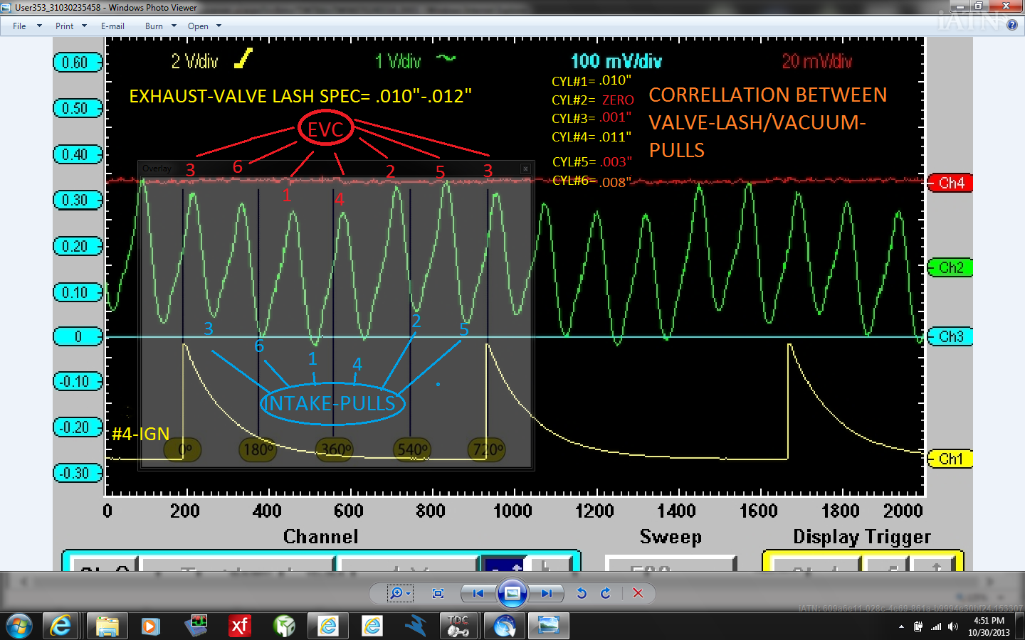

2005 Honda Pilot EX, Engine/Propulsion Waveform
Engine is cranking with spark disabled. FLS is displaying a differential between intake-pulls. valve-clearance was extremely-tight on cylinders #2,#3,#5 and somewhat tight on #6. Firing-Order is 1-4-2-5-3-6
