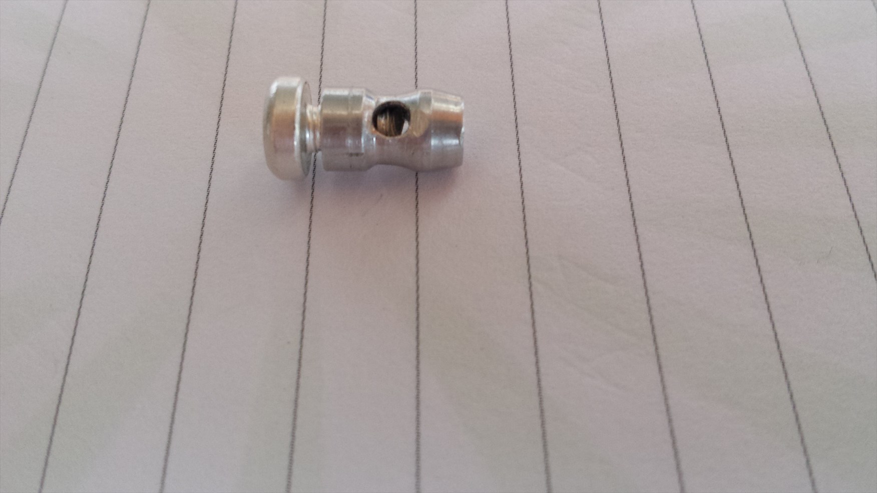

In a pinch you can make a cable stop from a spark plug terminal end. Just drill a hole for cable in the center. The threaded terminal takes a 10/32 screw.
