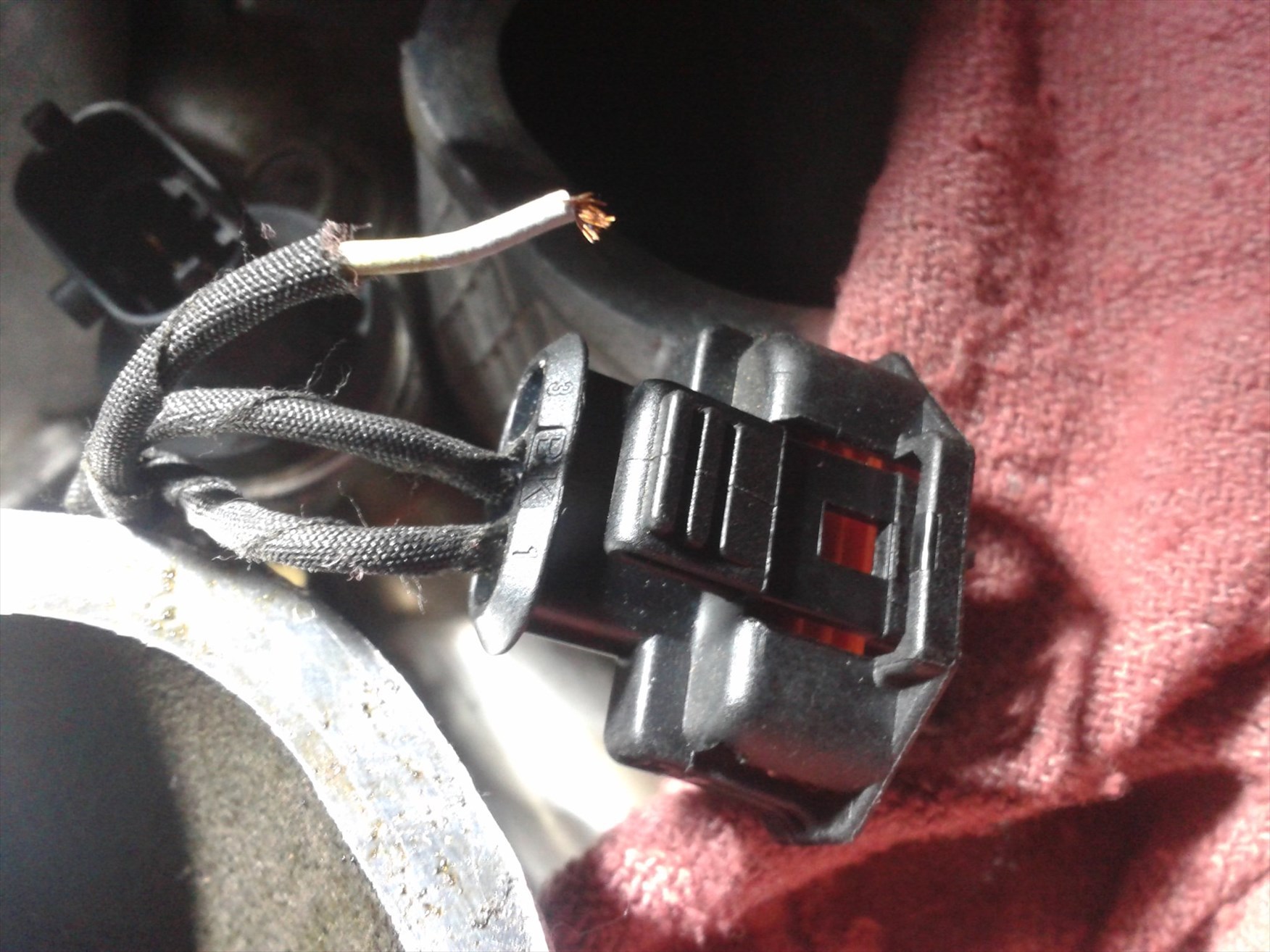

2010 Buick LaCrosse CXS, ECM/Inputs/Outputs Photo
Connector had a bad white wire that came out when tugged on. Replaced with a PT2798 ACDelco. This caused all kinds of rich and lean conditions with reduced power and stalling at times.
