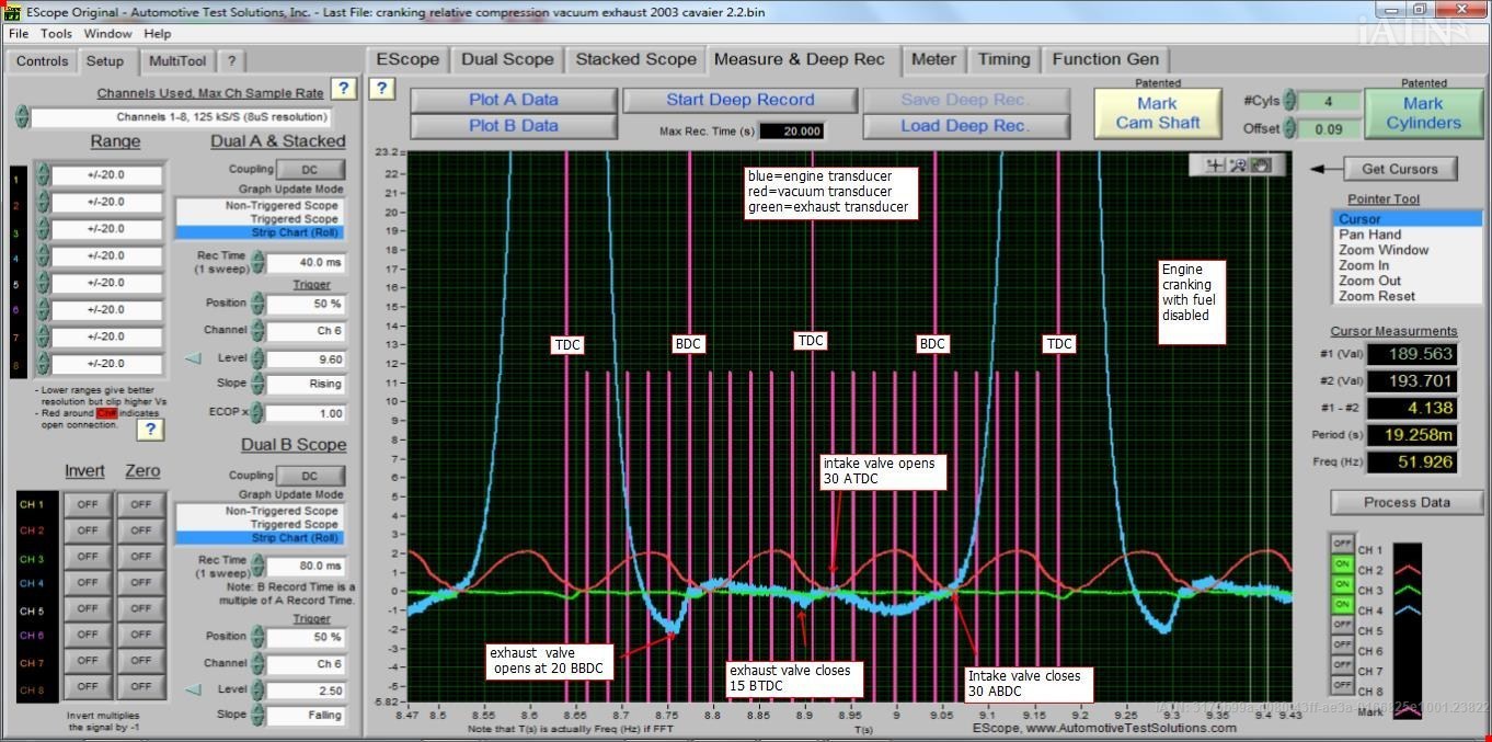

2003 Chevrolet Cavalier LS, Waveform
Cranking compression zoomed in. U can see when number 1 intake valve opens, there is a pressure drop in the cylinder waveform. This is different from the running compression waveform.
