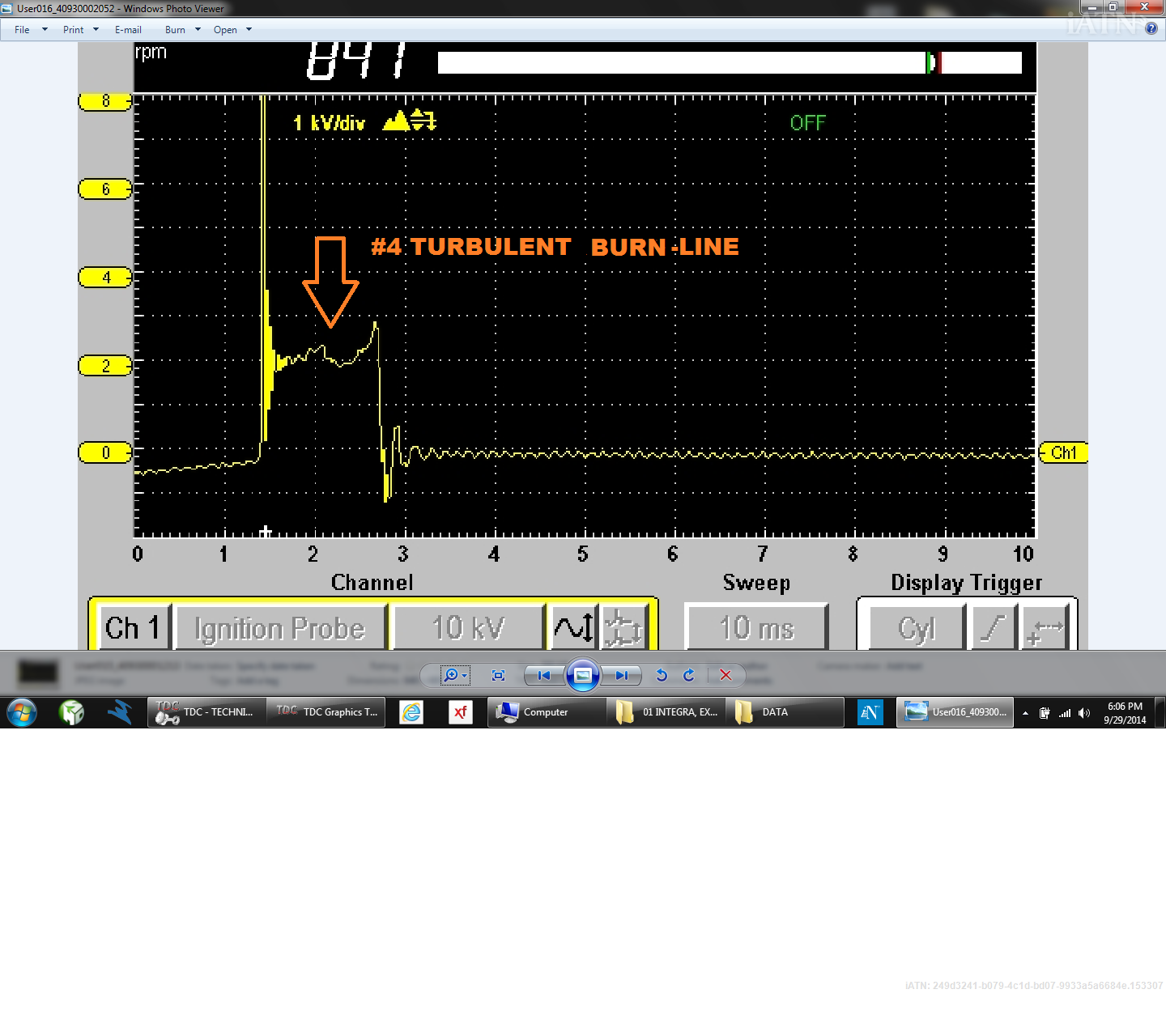

| 2001 Acura Integra GS-R, Ignition Waveform
                             Turbulence exhibited in the burn-line of Cyl #4 when the cylinder actually contributed with no misfire exhibited. Indicative of a column of air moving past the electrode, through the leaking exhaust-valve instead of being compressed without a loss of volume.
