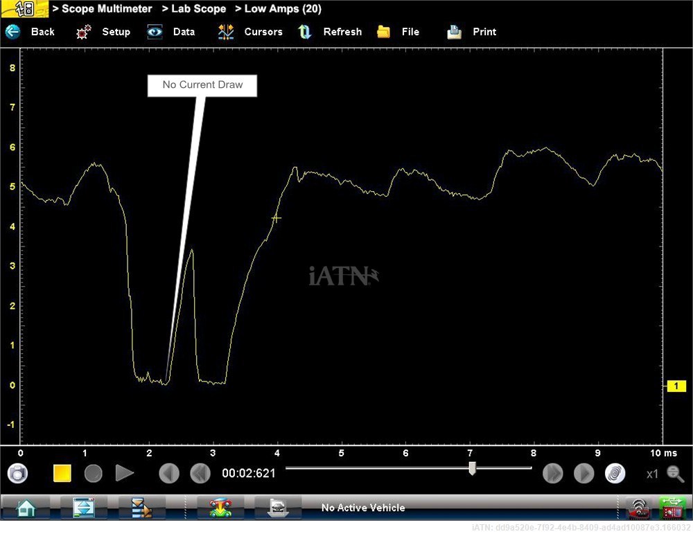

2000 Dodge Grand Caravan, Fuel Supply Waveform
Posted to the Waveform Library on 1/18/2013
Vehicle was a no start once a week.If fuel pump stopped on a flat line area, it would not start.
