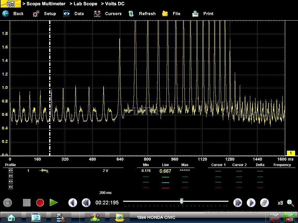

1994 Honda Civic DX, Engine/Propulsion Waveform
1994 Honda Civic 1.5L (16 valve) - Running compression of cylinder #1 while returning to idle, then under snap throttle. Translation formula: (((v-.5)/4)*314.7-14.7). .6v == -6.8325psi
