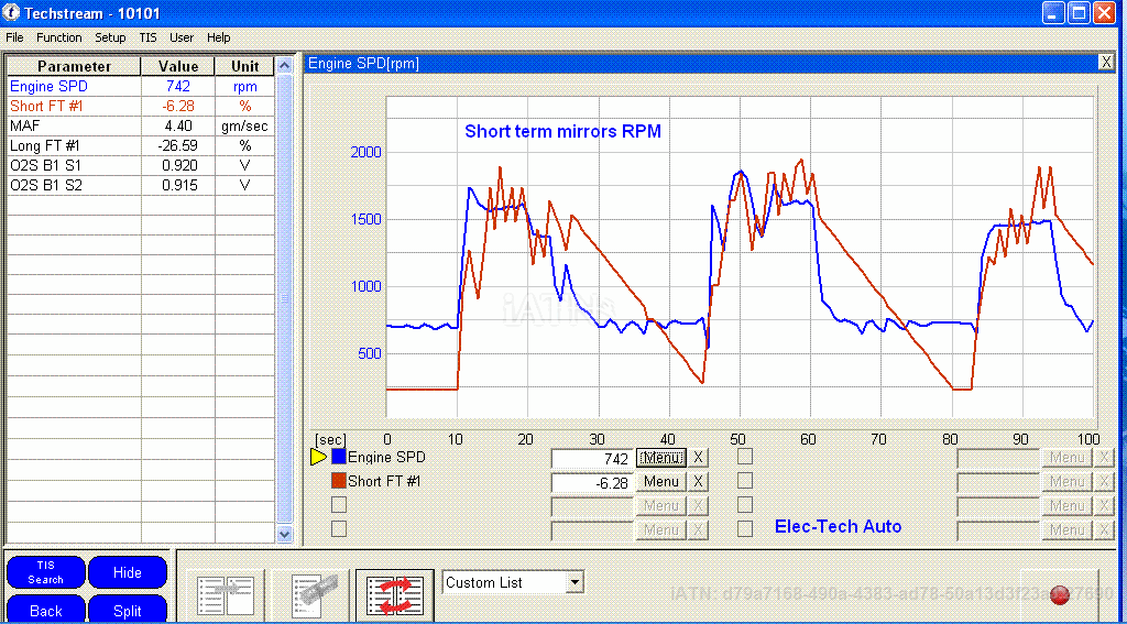

2001 Toyota Camry LE, ECM/Inputs/Outputs Scan Data
Checking a Maf sensor. Notice how short term and RPM mirror each other. This test is best done under light throttle tip in, under 3000 RPM.
