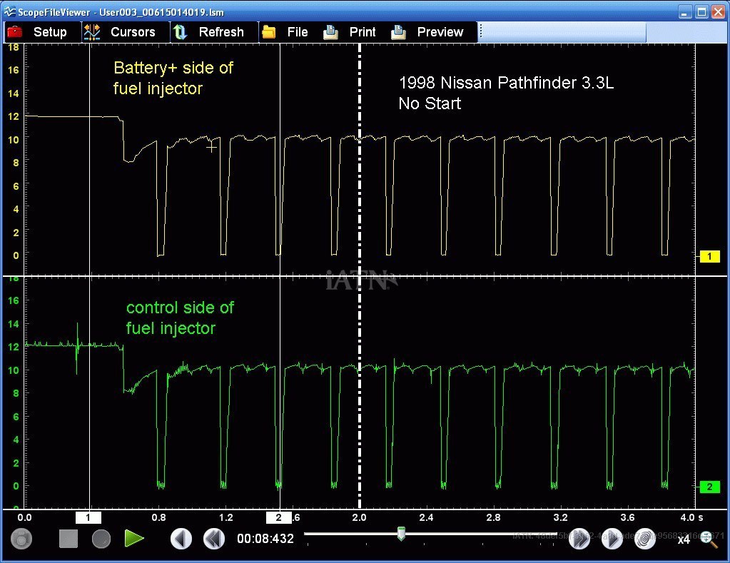

1998 Nissan Pathfinder LE, ECM/Inputs/Outputs Waveform
Another shop stated that the injectors were not making a "clicking" sound, intermittently. I first looked at the control side and didn't see a spike. I then dual traced the power and control side of the injector.
