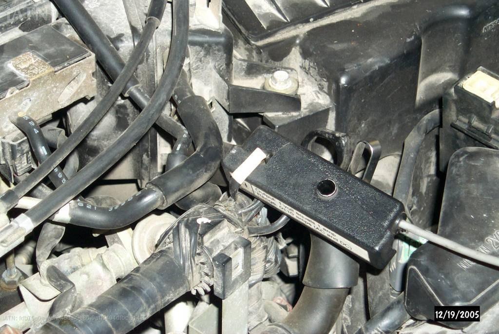

2000 Nissan Maxima, Ignition Photo
Posted to the Waveform Library on 12/19/2005
This is the loop where you attach low amp probe to check coil primary patterns. 99's only give you one coil at this point. 2000 and probably subsequent years give you all coils.
Bill from Kentucky
